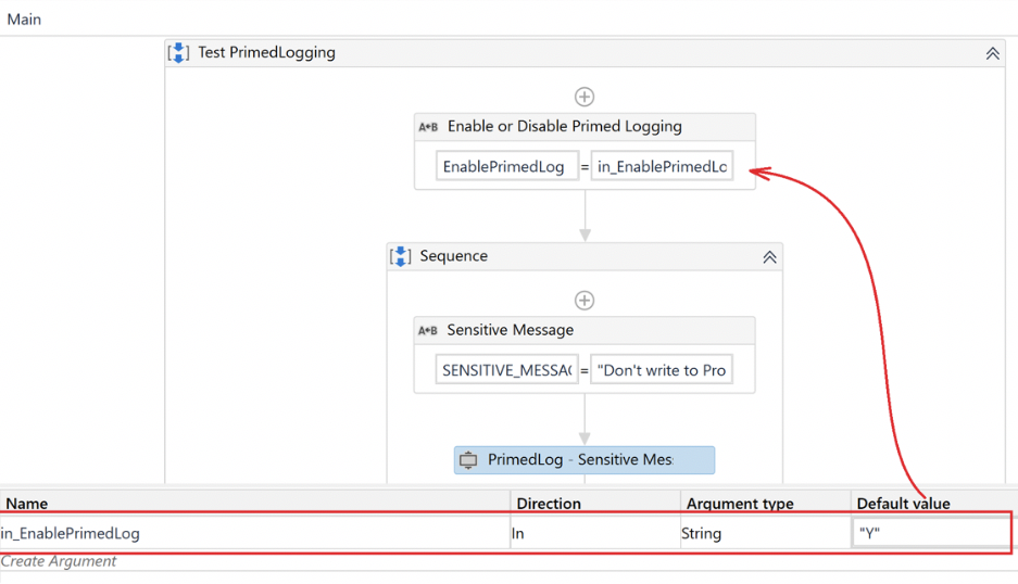

There are multiple ways to regulate this setting in your RPA processes:
  • Place the configuration setting in an external file and enable your RPA process to read this setting on startup.
  • Alter the signature of your startup Main.xaml file (as shown below) to accept an input argument that can then be overridden at the Process level or Job level when you finally deploy to the Orchestrator.
test primedlogging screenshot
start primedlogging test screenshot
As a best practice, it’s good to set the value of this configuration setting to N (or No) by default so that it becomes less painful and more secure when deploying your application to production. It can always be overridden in the development environment and set to Y (or Yes) to enable the logging of sensitive information for the purposes of development and testing.
