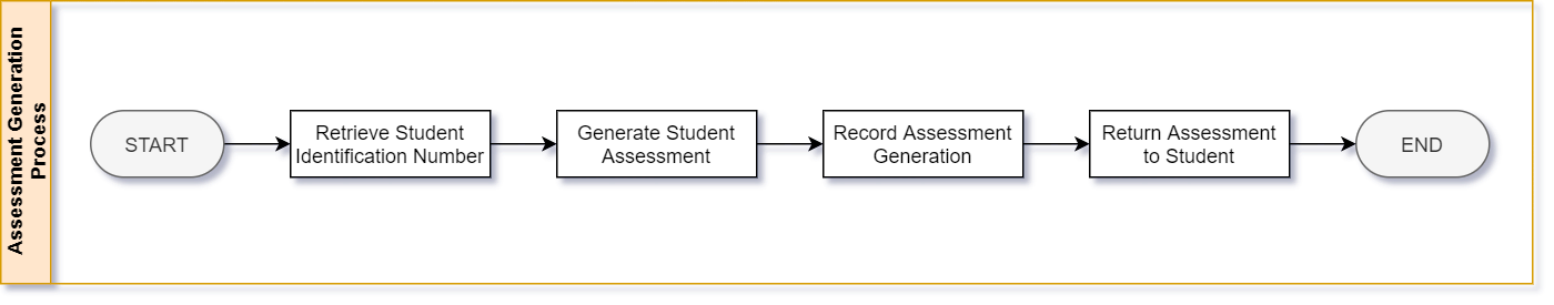

To overcome these challenges, I leveraged the integration between UiPath Apps and Data Center to generate custom tests for students. To provide a different assessment/test for every student, a process needs to:
1. Retrieve the student’s unique identification value (or number)
2. Generate an assessment specific to the unique student identification value
3. Record the assessment and make it available to the student for completion (Figure 1.)
 There are four core components to Figure 1.
high-level-assessment-generation-process-colour
1. The input: UiPath Apps can be used as the interface between the user and the rest of the solution that lives in the background. The user shouldn't have any access or ability to manipulate the process in any way.
2. The process: UiPath Studio can be used to develop the process that'll conduct the file manipulation and manage all storage. The process can be deployed to and run from the UiPath Orchestrator. The integration between Apps and Orchestrator allows for a process to be run from a button click from Apps
3. Storage: the storage component deals with data and files which, in this case, are stored separately. Files are stored in a UiPath Storage Bucket while all transactional data is stored on UiPath Data Service. The files could be stored in Data Service instead of Storage Buckets.
4. The output: since UiPath Apps is used as the entry point for users to interact with the solution, the output of the solution (which in this case, is the assessment) would be presented back to the student.
